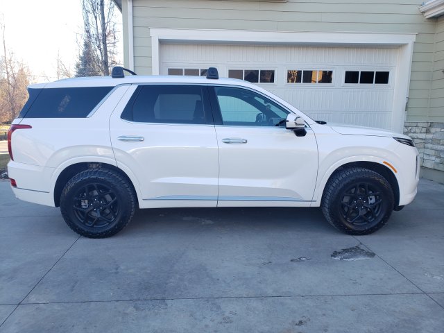

I put a 2 inch "lift" (leveling kit) on my Palisade and now it rides high in the front. I think the self-leveling got messed up somehow when I did it. Anyone have any idea how to adjust it to be higher on back so it is level again? It doesn't look like much in the picture, but it is enough that oncoming cars flash me as if I had my brights on.

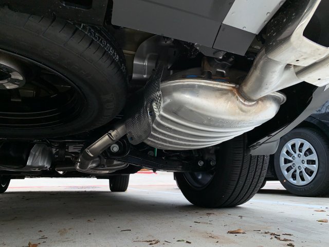

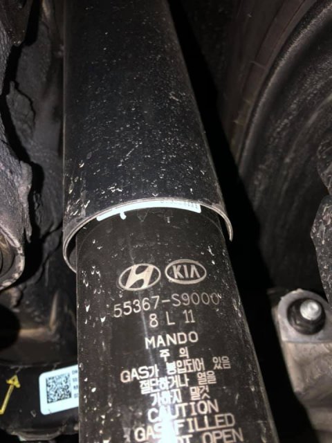

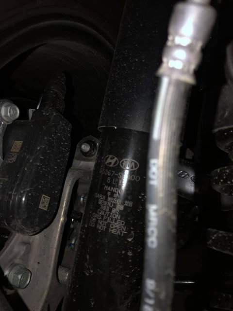

The Palis don't have the typical self-leveling suspension; it has self-leveling SHOCKS only. And they're not adjustable. You'd have to buy different ones for the height you need, and good luck with that :).
Do that to me too but it's mostly bc of the bright led headlights. Have you ever noticed that the palisade headlights make every street sign reflect. 🤔 most noticeable when turn signals are on at a stop light.

Not sure what lift kit you used, but looks like it was lifted higher in front than in back.
Does the kit use the OEM self leveling shocks? they are not adjustable.
Palisade led lights are really bright and that may be the problem.
I have a friend who had a 6" lift kit put in his pickup truck. He blinds everyone.
The higher you raise the car the more it will blind people.
